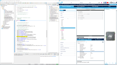

I noticed that CubeMX 6.14.0 ignores the octospi parameter settings. I created a new project for the NucleoU5A5 board, configured Octospi1 with a clock prescaler of 99. I notice the following behavior
I didn't check other settings. I have attached my ioc file

Hello @tzijnge ,
By loading the project that you have attached on the comment, I've set the clock prescaler: 99
OCTOSPI Parameters are well generated:

Thanks for taking the time to investigate my issue. I'm happy to hear that you are not affected by the issue, but things still don't work for me. DO you have any suggestions for moving forward? Or any clues as to what could be the problem?
