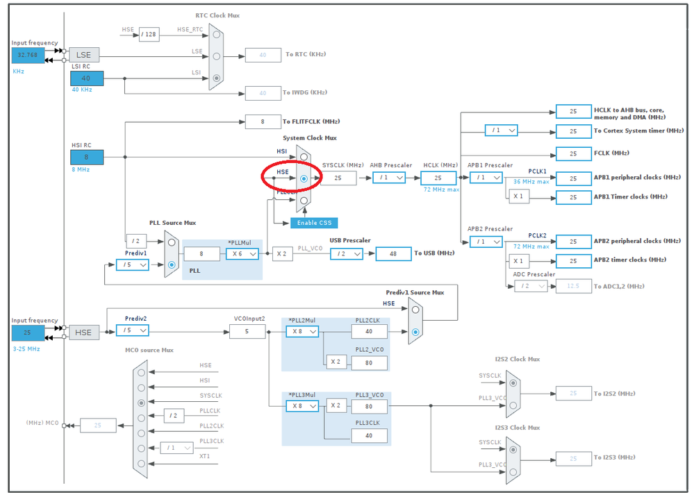

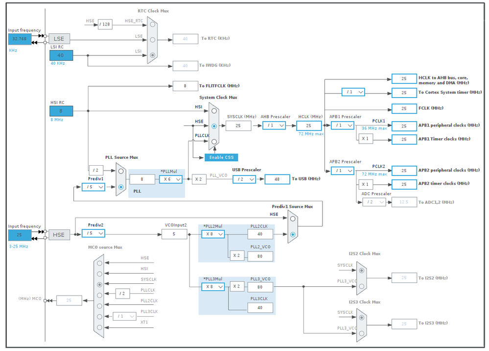

I am using STM32F105RC. CubeMX does not seem to configure PLL2 at all in SystemClock_Config(). Below in the clock configurator it is clear that I have enabled PLL2 to be used for PLLCLK and USB clock.
Seems like a CubeMX bug. Or if someone can point me to what I am doing wrong that would be appreciated.

The code snippet you posted seems fine to me, and you will find that exact same code snippet in my original post.
However, the problem is that code to configure and enable PLL2 is not being generated. (see line 18 in my code snippet). USB clock uses PLL and PLL uses PLL2, as my clock configurator screenshot shows, so PLL2 must be enabled and configured for USB clock to work.
