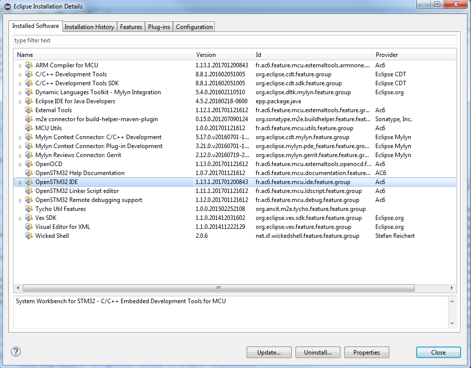

hello
Kim.Jisu
,I understand your point however, I can't reproduce it. When I change the optimization level in SW4STM32/Eclipse, the paremeter value is kept even if the project is reloaded.
On my point of view, the parameter optimization level is a parameter from Eclipse that is not given by CubeMX.
I wonder what arethe versions of your openSTM32IDE and ARM Compiler for MCU in Eclipse:
I have these versions :
If you don't have the version 1.1.201701200843, please upgrade it and keep me informed if you still have the issue or not.
BR. Eric

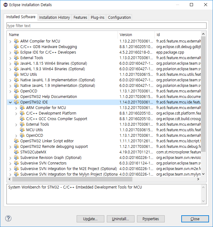

!Thank you for replying. My OpenSTM32IDE and ARM Compiler for MCU version is like below.
- OpenSTM32IDE : 1.0.201703061529
- ARM Compiler for MCU : 1.2.201703061592
I did reinstall CubeMX v4.1 but it didn't work too. So I installed CubeMX v4.0 and it fixed my problem.
well, I don't know what was problem, but now goes well. That's weird...
here's my eclipse installation details.
Thank you!

2017-07-10 5:29 AM
I'm having the exact same issue.
CubeMX 4.21.0
OpenSTM32 IDE 1.13.1.201701200843
ARM Compiler for MCU 1.13.1.201701200843
