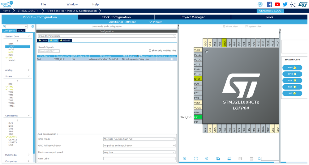

Board selected on CubeMX: STM32L100C-DISCO.
Input Capture with TIM2, Channel 2, Pin A1.
I've been working on a project where I have to measure frequency, so I setted up the Input Capture on Timer 2 as in the Picture:
After exporting the code, and implementing the functions as needed based on a tutorial I watched I didn't get any result out, nor any execution of the interrupt that should start at the capture event, what I noticed is that the GPIO pin is being declared as a alternate function push pull output instead of an input... is that ok?, you can watch that in this picture:

Thanks in advance for your comments, I am not posting the code as I first would like to check that the way cube mx is showing the info as in the pictures is correct...
Yes.
When set as AF, the connected peripheral controls the actual direction of the pin, i.e. whether it's input or output.

Thank you very much for your answer, now I know the problem must reside somewhere else, I will post again in case I can't solve it by myself.
