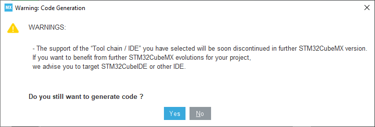

As far as I understood, stm32cubeMx will be end of life within some days / months / years.
Can you provide timeline for it?
And will it be released as open source project at this moment?
Thanks
Julien

It's not a rumour, it's what I understood from this screenshot that obviously I read it the wrong way... :D

So, I understand that cubeMx stand alone is not end of life. Only support of trueStudio.
Open sourcing is still a question to me.
2022-01-03 6:59 AM
The message says support for your IDE (TrueSTUDIO) will be discontinued. It makes no mention of CubeMX being deprecated. The message is quite clear.
This makes sense as TrueSTUDIO has been NRND status for quite some time.
I don't see any indication that CubeMX will be open sourced.
