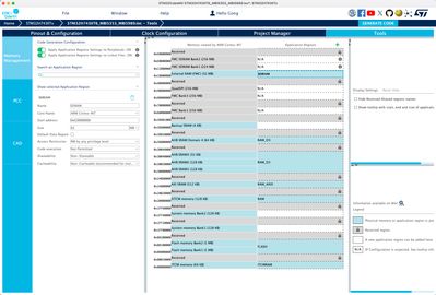

MCU: STM32H743IIT6
When using Cubemx on Mac M1, enable "Apply Application Regions Settings to Linker Files", the generated .ld file error

After checking, it seems that the issue is only observed when generating a CMake project, moreover when disabling the Code Generation Config in MMT, the .ld file is generated correctly.
Actually, the Cmake toolchain was added recently in CubeMX, but it currently does not support MMT.
The support of MMT with the Cmake project in STM32CubeMX is planned for the coming releases.
