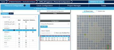

Hello @stm64 ,
STM32CubeMX should display the GPIO Settings such as the case with Nucleo-H7S3L8.
An internal ticket has been raised to the dedicated team (Ticket Number: 225239).

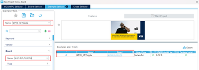

2026-01-14 11:03 PM
Hello @stm64 ,
Let me thank you for your post.
For more investigation, could you please provide which example are you using.
Thanks.
Mahmoud
2026-01-14 11:48 PM
GPIO_IOToggle NUCLEO-C031C6 version:6.12.0
Thanks.

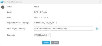

2026-01-15 12:39 AM
Hello @stm64,
Further to your comment, STM32CubeMX 6.16.1 provides an example GPIO_IOToggle with an Ioc.File.
I suggest that you select it and click on start project.

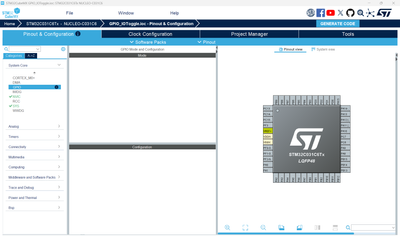

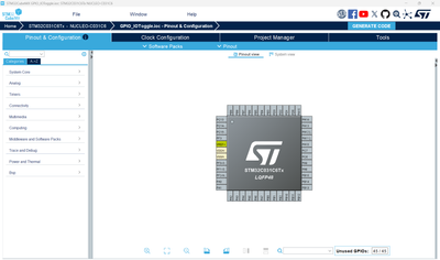

2026-01-15 1:15 AM
This is how I did it. After clicking the steps above, CubeMX opened automatically. As shown in the image below, the CubeMX interface does not display the GPIO configuration.
Although when I import it into cubeIDE later, I can see the GPIO_IOToggle code and the function works normally.
I want to see how the GPIO_IOToggle example is configured graphically in cubeMX, but I can't see it here.
Thanks.

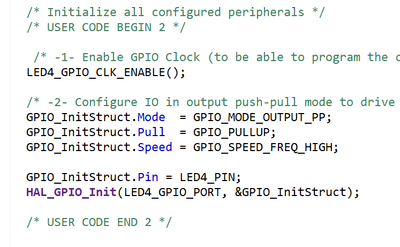

2026-01-15 5:42 AM
There's no way to change how the example is set up, but you can change a pin to be GPIO_Output and it will be initialized as such in the code.
Configuration of the pin is done in user code within the example, not from within STM32CubeMX.

2026-01-16 1:54 AM
I know what happened. The GPIO_IOToggle and GPIO_EXIT example files for NUCLEO-C031C6 are corrupted, while the other examples can display the graphical configuration correctly in cubeMX.
Thanks.
