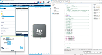

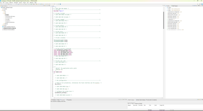

2025-11-13 7:22 AM - edited 2025-11-13 7:35 AM
Hello @ACC
Could you please provide more details about your OS.
I have tested your IOC file, "DELME_Updated_Project.ioc," and, as shown in the screenshot, the generated code is correct.
Afterward, I configured additional peripherals (ADC1 and DAC), regenerated the code, and confirmed that everything is working as expected.

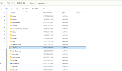

So I suggest that you close the CubeMX and then delete the following folder .stm32cubemx (On Windows: C:\Users\<YourUsername>\.stm32cubemx)
Then Restart CubeMX and try again generate the code using your IOC and make sure to use a new workspace
