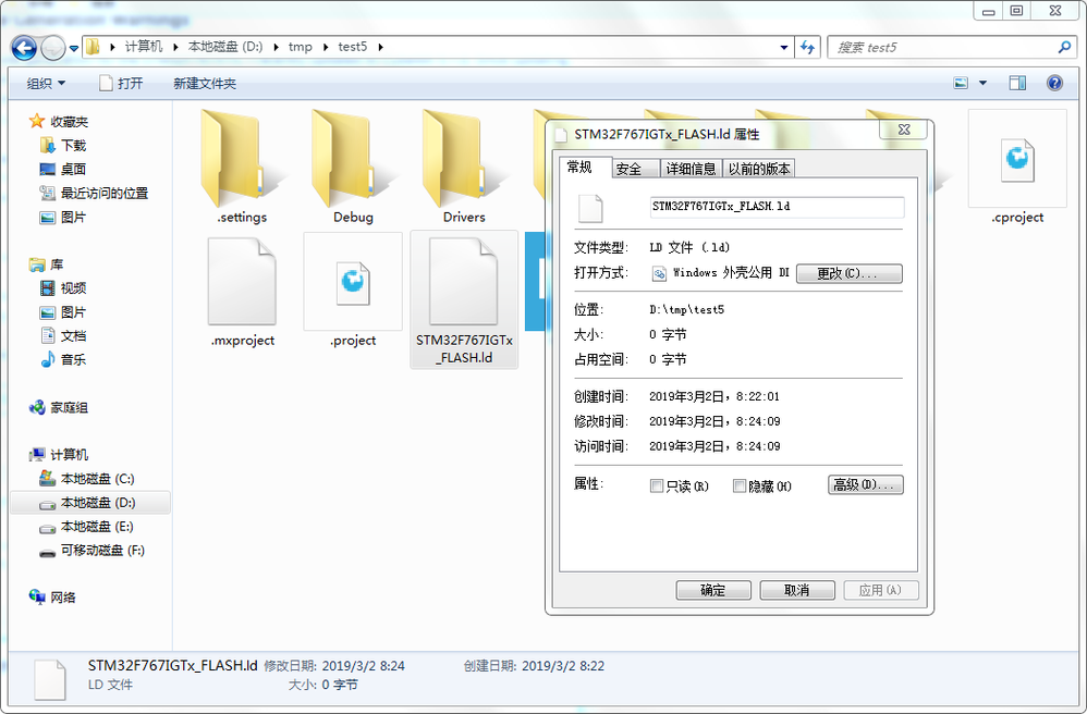

CubeMX5.1.0生�?SW4STM32代�?第一次正确,�?新生�?之�?�,STM32F767IGTx_FLASH.ld�?��?空文件,file size = 0。怎么办?

As all tools, bugs lurks around. Most important is to check the generated code and see if it looks ok for debugging.
