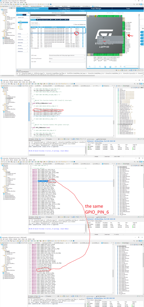

How to fix that?
Thanks
2021-12-08 11:52 PM
CubeIDE generates the source code of EXTI handlers incorrectly: inserts the wrong names into the HAL_GPIO_EXTI_IRQHandler () handler with custom labels

Welcome, @AFinn.1, to the community!
You have marked GPIO_PIN_6 in the third and fourth screenshots, but they each belong to different GPIO ports:
This is also listed in the lines below that defines the GPIO port:

Hello, in my opinion this is an issue. If you define two User Labels (in my case analog input PA1 as ABC and EXTI PB1 as DEF) configuration tool will generate automatically in main.h:
#define ABC_Pin GPIO_PIN_1
#define ABC_GPIO_Port GPIOA
#define DEF_Pin GPIO_PIN_1
#define DEF_GPIO_Port GPIOB
than in stm32f1xx_it.c configuration tool will use incorrect User Label automatically generating interrupt handler
void EXTI1_IRQHandler(void)
/* USER CODE BEGIN EXTI1_IRQn 0 */
/* USER CODE END EXTI1_IRQn 0 */
HAL_GPIO_EXTI_IRQHandler(ABC_Pin); <------------in my opinion should be DEF_Pin
/* USER CODE BEGIN EXTI1_IRQn 1 */
/* USER CODE END EXTI1_IRQn 1 */
I know, that finally that both ABC_Pin and DEF_Pin have same value, but it is a little bit frustrating
Best Regards, Boguslaw

@Imen DAHMEN It is easy to recreate: PA1=ADCx, PB1=GPIO_EXTI1, NVIC=ENBL EXTI -- generates exactly the code shown by Bogulaw for EXTI (confirmed with several STM32).

Hello @AFinn.1 ,
Thanks for your feedback,
This issue was already detected with other STM32 and raised to the development team. I'll keep you posted with the updates.
** Taking the example of PC6 and PA6, both pins CAN be configured as GPIO_EXTI6 **
In EXTI9_5_IRQHandler(), user will find the following HAL_GPIO_EXTI_IRQHandler(Output_PA6_Pin) instead of HAL_GPIO_EXTI_IRQHandler(EXTI_PC6_Pin);
Workaround :
Either remove PA6 user label or set its state to reset state, this will give you a correct generated code.
