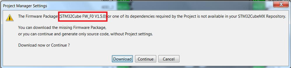

You are using an old version of firmware.
Please use the firmware package ''stm32cube_fw_f0_v1.7.0'' which is compatible with the CubeMX version 4.20.0.
You may refer to
table5 for further details about the supported firmware package versions.In the updated firmware, the ''TIM_AUTORELOAD_PRELOAD_ENABLE'' is defined in ''stm32f0xx_hal_tim.h''Khouloud.

, unfortunately, I had the F0_V1.5.0 installed in my PC and because of this I didn't get any error message.Originally the project was made with an old version of the CubeMx and HAL Libraries.
Probably there was a problem, -without any message-, during the migration process.
I supposed that the migration process should change 'automatically' the reference to the correct HAL Libraries.
Now I disinstalled all the old versions of the HAL Libraries, and I will keep only the last one available, at least in this way for the future releases I should get the message you show to warn me about wrong version of the library.
I changed the reference to the correct library version in the project.
With this modification, I solved the problem and there are no more errors in the generated code.
It should be nice to have an error or at least a warning message from the CubeMx also if the old library referenced from the project is already installed in the PC.
I never get any message about old version of the referenced library by the project.
