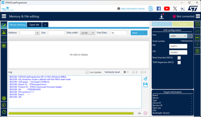

while in the CubeProgrammer app, doing, I guess, exactly the same, this is the output:
It's showing the same output but with an extra line:
08:53:09: UR connection mode is defined with the HWrst reset mode
If I search in the cli documentation it says that this is reserved only for JTAG/SWD debug:
-hardRst : Hardware reset
Available only with JTAG/SWD debug port
So why I am getting this line if I am connecting over DFU? and why is that line not showing in the output of the USB_example.cpp code?
