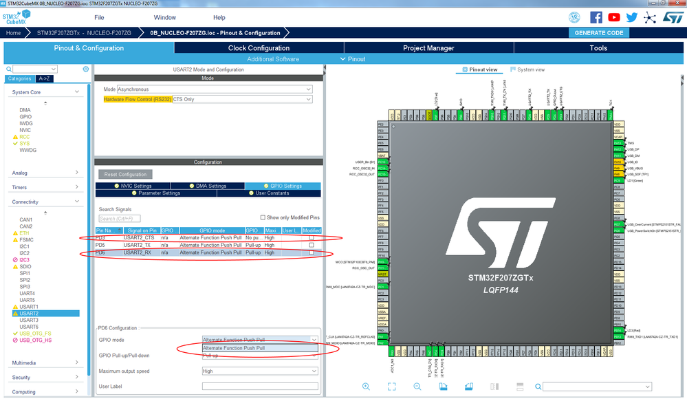

hi, I am working with the NUCLEO-F207ZG card and I have configured USART2 on port D.
Now CubeMx offers me the setting of the RX pin in Push-pull mode !!!!!! The same for CTS !!!
And there is no way to set the pin in any other way !!!
Can anyone give me an explanation ???

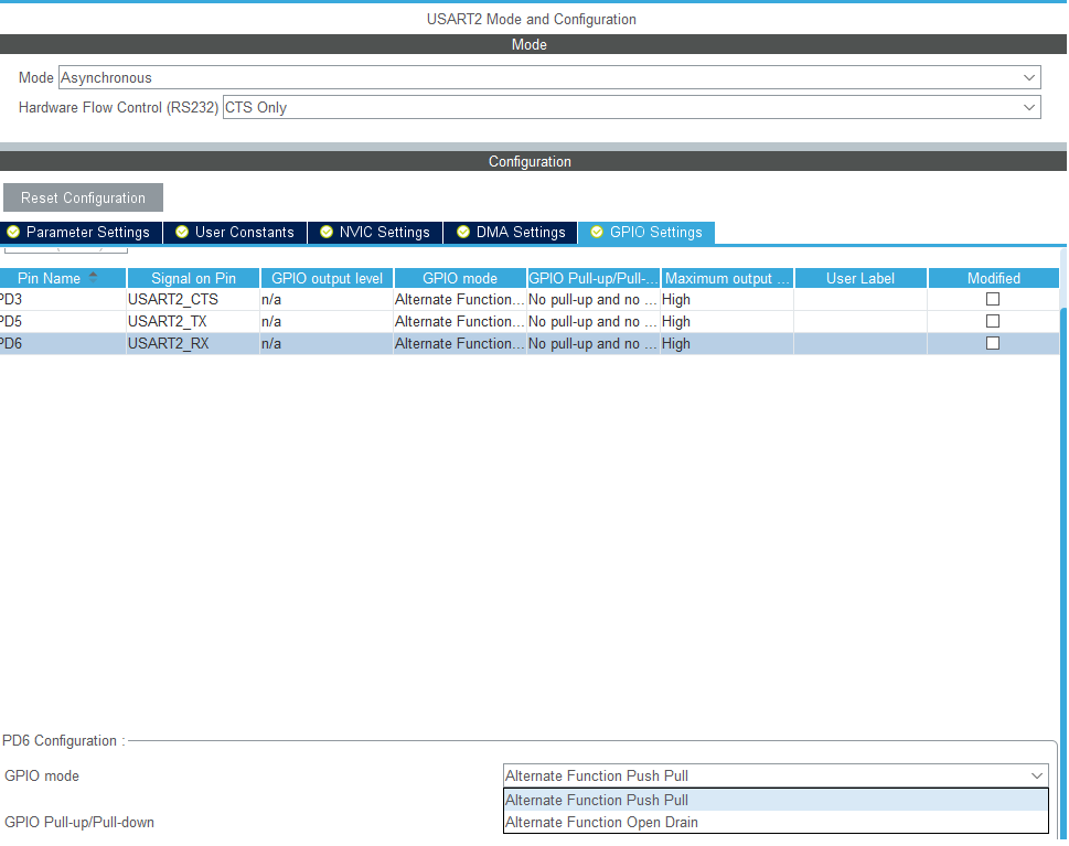

After check with STM32CubeMX V5.6.0, it is possible to select open-drain mode for USART2_RX (see my attached screenshot).
so, please update and use the latest version of STM32CubeMX.

Hello @Zano,

2020-04-02 5:58 AM
Okay Imen, thanks for your answer,
but this is still wrong in my opinion, cube-mx continues to set the usart RX pin as if it were an output.

According to the reference manual, we can add the "Open Drain" mode option at alternate function:
"When the I/O port is programmed as alternate function:
• The output buffer can be configured as open-drain or push-pull"
