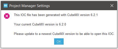

3) try to reopen the project with v6.2.0, these window will popup:
I need to use this project with 6.2.0 version of Cube MX.

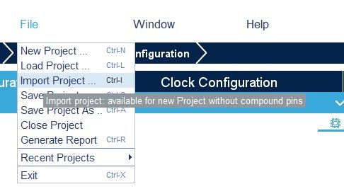

Thank you for having reported. Actually, on project load, STM32CubeMX detects if the project was created with an older version of the tool and if this is the case, it proposes to either migrate to use the latest STM32CubeMX database and STM32Cube firmware version, or to continue.
Clicking continue keeps the database used to create the project untouched.
Assuming that you've clicked the Migrate button to use the latest STM32CubeMX version 6.2.1 and save the modification you've done, it will not be possible to use an older STM32CubeMX version.
What I can propose in this case is either to:
For more details about the Import project feature, you can refer to the STM32CubeMX User Manual.

Hi khouloud and thanks for the answer.
In fact, I have not clicked Migrate, i just opened the 6.2.0 project with the 6.2.1, and just exporting the code from there (so saved automatically) , the .ioc resulted generated by the 6.2.1 version, a different behaviour from the one described in your message..
So the project is not left untouched at all!
