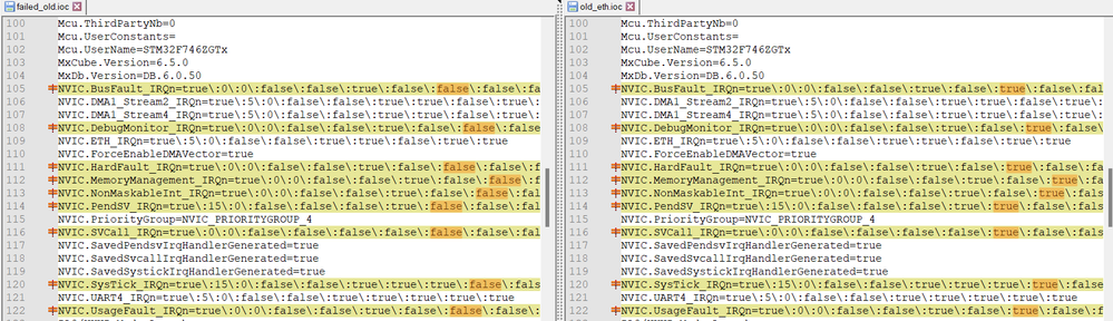

Comparing my old .ioc project (based on former version of cubeMX) and a fresh new .ioc I found those differences:
but I see no difference in the CubeMX interface NVIC.
Does someone know at what parameters corresponds each filed of line like this:
NVIC.DMA1_Channel4_5_6_7_IRQn=true\:0\:0\:false\:false\:true\:false\:true ?

I'm having trouble with my Ethernet.
And after comparing a .ioc from a working ethernet project and a non working project I found the same as you.
The failed one have a lot of parameter set to false. And for the working project, it's in true.
That's the only difference.
Same question as you. Where should we manage this ?

2023-11-20 9:18 AM
In case anyone stumbles upon this question:
I have extensivly tested the behavior of CubeMX regarding the NVIC vector and it appears that CubeMX somehow memorizes user interaction on the NVIC settings with the setting located at the 4th position from front and 3rd from end. However, I could not observe any impact on the code generation regarding those two flags.
In my observations, the latter one (3rd from end) changes from false to true when manually enabling or disabling the IRQ and never changes back. However, I could be wrong.
Hope this is helpful for somebody.
