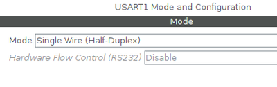

and can you (i dont have this chip, but all similar ) define in Cube half duplex? then only one pin is used.

yepp, on half duplex the "TX" pin is used, pa2 here. but now you get pa15 free to use...for exti.

Selecting half duplex MX selects PA2!
PA2 in the only pin for USART2_TX and MX persists in selecting this pin when USART2 is selected.
If we put PA2 in reset state USART2 is automatically disabled.
Same behavior with USART3.
It seems that MX does not allow to use an UART for RX only. For me it's a bug... Because I commonly do it without using MX.

For normal mode selecting "Receive Only" or "Transmit Only" doesn't release the respective unneeded pin. For "Single Wire (Half-Duplex)" mode enabling the "TX and RX Pins Swapping" doesn't move the single allocated pin from Tx pin to Rx pin, which is what the hardware actually does. That's just what RubeMX is. And what's the point of all of this contraption? The HAL broken bloatware cannot receive USART stream without ridiculous hacks anyway. Toss it all away and develop a useful and working code:
