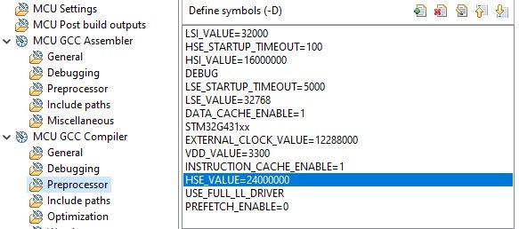

2021-01-05 4:21 PM
Evaluation is covered, no issues there.
>HSE_VALUE
>Not unless you've added it as one. It's typically first defined in stm32xxxx_hal_conf.h, but only if it's not already defined, as outlined in my reply above.
I promise I didn't. As soon as you enable HSE and set the frequency in clock configuration it adds it. Or do you mean I should not define this in CubeMX?
Example of defines done for one a project for STM32G4 by CubeMX with CubeIDE as Toolchain/IDE.

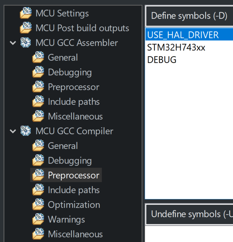

2021-01-05 5:36 PM
Huh, well there it is. Hard to argue with that. My screen looks very different from yours for a project generated for an STM32H7 (and STM32F4, literally just tested it). Wonder if it's because you're using LL drivers?
Edit: I can't duplicate what you're seeing, regardless of what I do. HSE enabled, LL enabled, still nothing else shows up under defines. Maybe you've converted an old project and these have carried forward?
2021-01-06 2:15 AM
Wow. That's a big difference. Must be HAL vs LL because I just tested with a new project.
