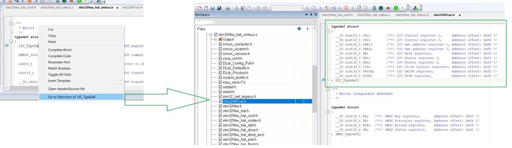

Furthermore, the I2C_TypeDef structure (in stm32f4xx_hal_smbus.h file) is defined in the stm32f401xe.h which is the CMSIS STM32F401xE Device Peripheral Access Layer Header File containing :
Noting that I'm executing a simple test case using STM32F401RETx MCU, but this is generic for all MCUs supporting SMBus peripheral.
