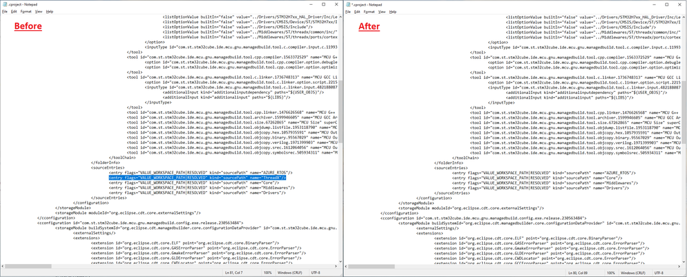

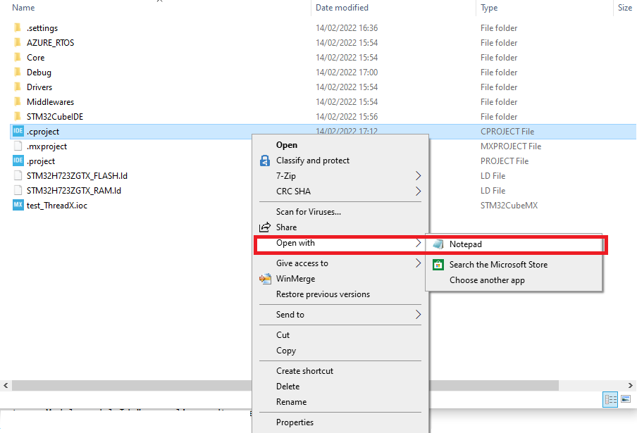

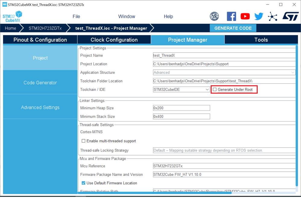

The Warning message is not supposed to be generated, there is no ThreadX folder except for the one generated in Middlewares folder. This message does not impact the generated code and only generated when "Generate Under Root" option is checked in Project Manager in CubeMX.
Unchecking the "Generate Under Root" option and regenerating the project will not remove this warning. It has to be unchecked from the start or you can do the following two steps on your current project:
After doing these two steps, the warning message will no longer be displayed.

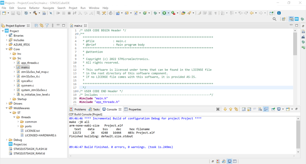

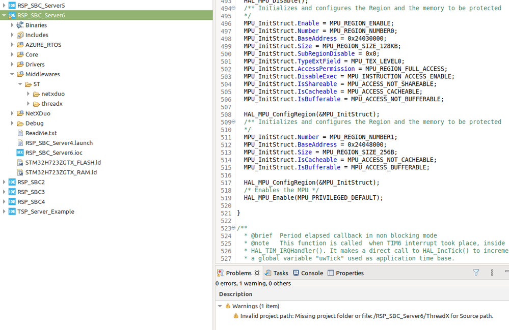

2022-02-11 10:36 AM
I can do even better. Here is a screen shot first of all showing that the threadx files are in the Middlewares folder as expected and they compile fine. However if you look down and to the right you can also see the warning of a missing project folder and if you go back to the project tree you can see that the folder is not there.

Please note that while CubeMX has an option to "generate under root", CubeMXIDE seems to have this option permanently checked with no way to change it.
2022-02-14 9:40 AM
Just to confirm what Harvey stated, CubeMX (standalone) allows the "generate under root" option to be unchecked, but the MX perspective in the the STM32CubeIDE does not allow "generate under root" option to be unchecked. Also I am not sure one would want to uncheck this feature as it would then not conform the placement of the project files in a way that supports the Eclipse methods for archiving and copying projects.
