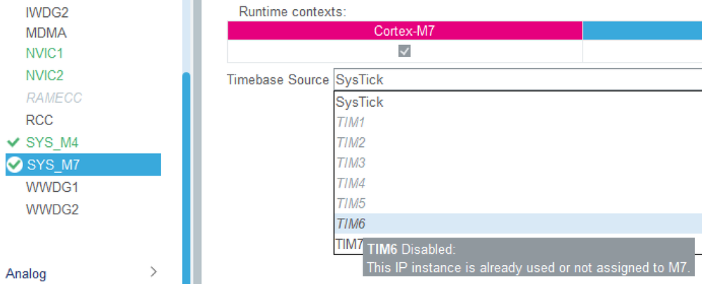

But when I try to change the timebase to TIM6, the option is disabled

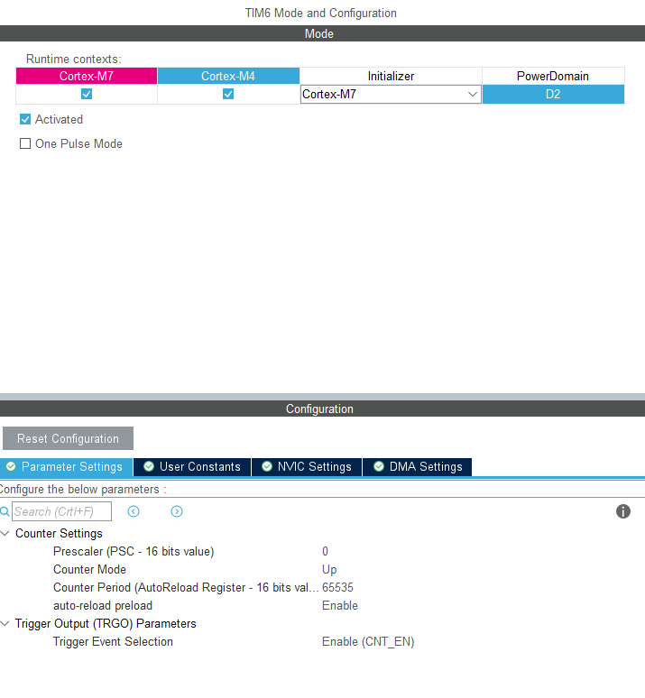

I have enabled TIM6 as below:
Can you please let me know what I am doing wrong.

If you hover over something that is grayed out, it will tell you the reason. In this case, probably you will see this:
So because it's used by the M4 core, it can't also be used by the M7 core. Selecting a different timer for each core will work.
