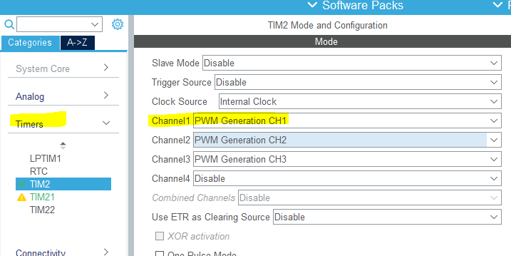

Hi @Gz ,
You can generate PWM with CH1 for TIM2 by select PWM Generation CH1 under Timers -> TIM2.
Hope that this help you!
