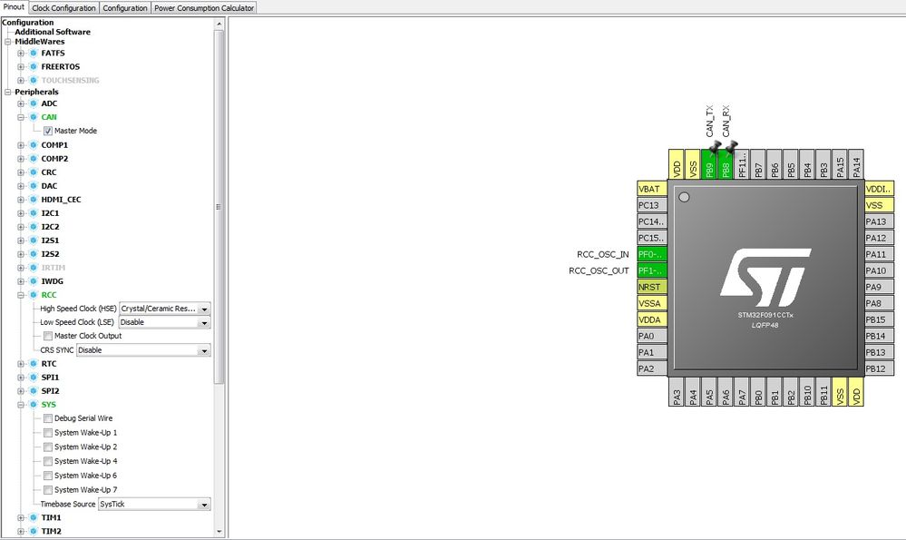

I set the PB8 and PB9 outputs to Can Rx and Can Tx in the microcontroller schematic.I have chosen HSE crystal in the RCC as a clock because I have always seen it in similar cases.

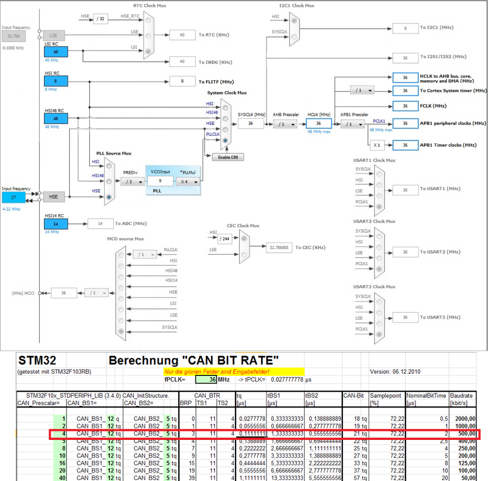

When I look at the clock settings, I learned that FCLK is used for the CAN bit rate setting. I set the clock rate to be 36Mhz according to the settings in the prescalar table because the bit rate I want to work is 500kbit/sec.
To adjust the CAN settings, I made the Prescaler settings as seen in the table above.

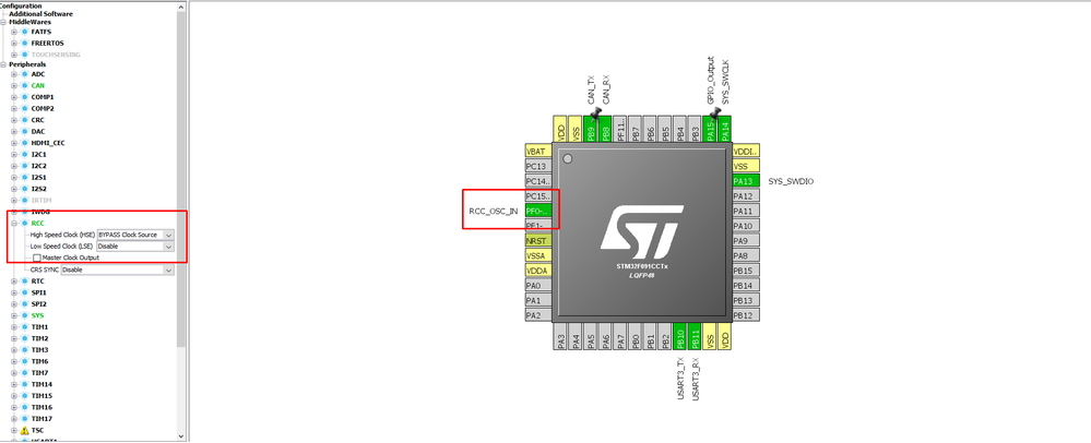

I resolve my problem. My problem is selecting HSE clock as an Crystal Clock ( 2 pin ). My external clock has 1 pin so i changed it as BYPASS clock source and it works!!
