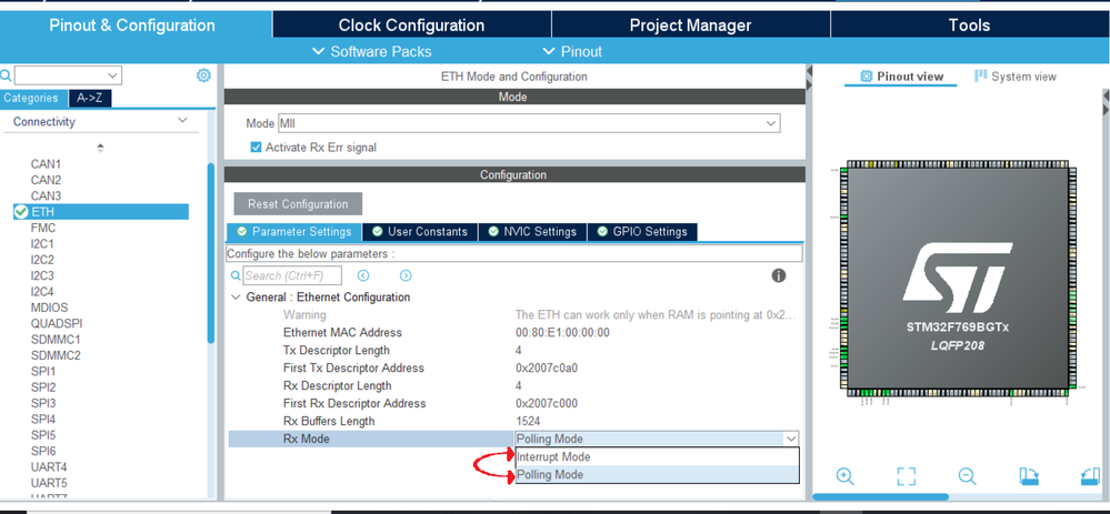

When generating with ETH interface, changing the Rx Mode from Polling Mode to Interrupt Mode do not change anything!
The ioc is changed, but none of the .c/.h files

So, what should be modified to use the ETH in interruption mode?

Hello @ANauz.1 ,
Working with CubeMX 6.7.0 and F7 Firmware 1.17.0 and changing the Rx Mode from Polling Mode to Interrupt Mode in two different projects
And I found these changes in the project that uses "interrupt mode" as "Rx mode" in the following files:
Core\Inc\stm32f7xx_it.h
void ETH_IRQHandler(void);Core\Src\stm32f7xx_hal_msp.c
/* ETH interrupt Init */
HAL_NVIC_SetPriority(ETH_IRQn, 0, 0);
HAL_NVIC_EnableIRQ(ETH_IRQn);Core\Src\stm32f7xx_it.c
* @brief This function handles Ethernet global interrupt.
/* USER CODE BEGIN ETH_IRQn 0 */
/* USER CODE END ETH_IRQn 0 */
HAL_ETH_IRQHandler(&heth);
/* USER CODE BEGIN ETH_IRQn 1 */
/* USER CODE END ETH_IRQn 1 */
}Hope this answered your question.

I just test again and:
void ETH_IRQHandler(void);Is present in Core\Inc\stm32f7xx_it.h in interrupt and polling mode
}Is present in Core\src\stm32f7xx_it.c in interrupt and polling mode
I have nothing about ETH It in Core\Src\stm32f7xx_hal_msp.c in interrupt and polling mode
So, in my configuration, (µC in TFBGA216, and Makefile), the generate project has no difference in interrupt nor polling mode on the ETH interface.
