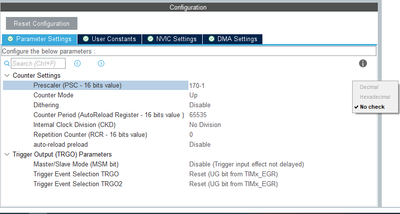

Hello @KnarfB
I'm able to reproduce the described misbehavior. This issue need to be fixed from future releases. But in the meanwhile, you will need to change the cell parameter to "No check" as shown in the screenshot bellow.
Whit this been said, I will raise the issue internally for analysis and fix. Internal tickets number: 1156332 (This is an internal tracking number and is not accessible or usable by customers).
