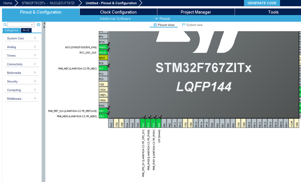

Hello VGari.1,
I don't really understand the problem, but when I start a new STM32CubeMX project using Nucleo-F767ZI board and initialize all peripherals with their default Mode, PB0 is correctly assigned to LD1[Green] (please see attached screenshot of the Pinout view below ). The code also is correctly generated.
Thus I can't find the issue, waiting for your feedback if I miss something.

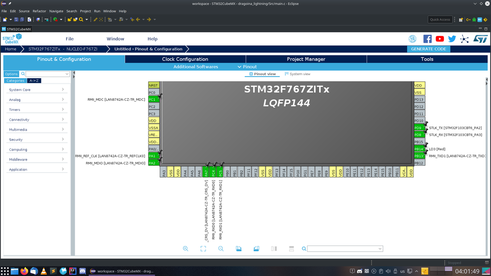

2020-08-01 6:09 PM
Perhaps the standalone CubeMX and the plugin for AC6 System Workbench behave differently. I am using the latest version of CubeMX plugin for System Workbench on Arch Linux. This is how a brand new project with Nucleo-F767ZI looks like on my machine:
2020-08-03 5:14 AM
I can't reproduce the issue using the last version of STM32CubeMX standalone and even when opening a new Nucleo-F767ZI project through the last version of STM32CubeIDE (check https://www.st.com/en/development-tools/stm32cubeide.html for download).
I have tried on both Linux and windows machines and I get always correct initialization.
BR,
Khouloud.
2020-08-07 11:28 AM
Alright, there must be something wrong on my end. If it can't be reproduced then I guess it is not an issue.
Thank you for looking into it.
