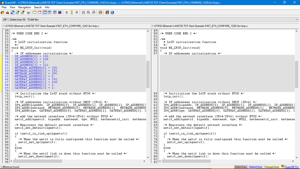

The definition of these variables was missing (FW_F4 1.25.0), the generated code did not insert this part:
File Src/lwip.c (line 58)
void MX_LWIP_Init(void)
/* IP addresses initialization */
IP_ADDRESS[0] = 192;
IP_ADDRESS[1] = 168;
IP_ADDRESS[2] = 1;
IP_ADDRESS[3] = 111;
NETMASK_ADDRESS[0] = 255;
NETMASK_ADDRESS[1] = 255;
NETMASK_ADDRESS[2] = 255;
NETMASK_ADDRESS[3] = 0;
GATEWAY_ADDRESS[0] = 192;
GATEWAY_ADDRESS[1] = 168;
GATEWAY_ADDRESS[2] = 1;
GATEWAY_ADDRESS[3] = 1;
/* Initilialize the LwIP stack without RTOS */
lwip_init();Update 3:

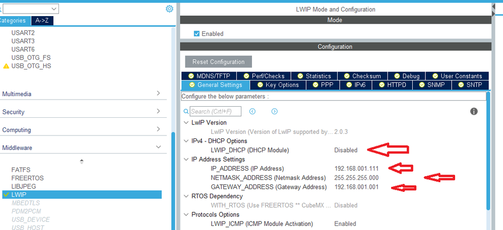

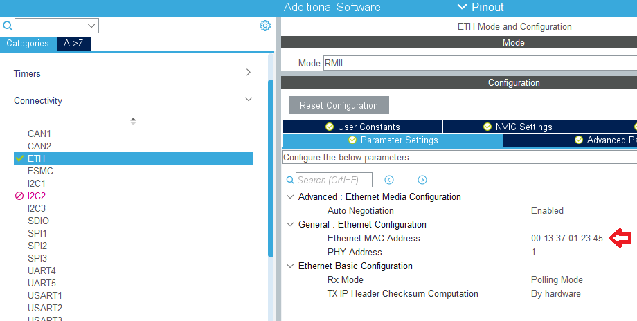

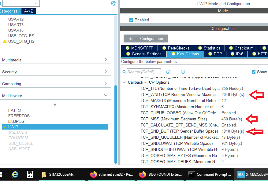

I found an example, step by step, of using the LAN8720, including video, but ping.exe is not receiving responses.
It seems that there were some changes in the automatic code generation.
What could be happening?
The LEDs on the network card are showing activity, the connections between STM32F407VG and LAN8720 show activity only at startup, should there be activity all the time?

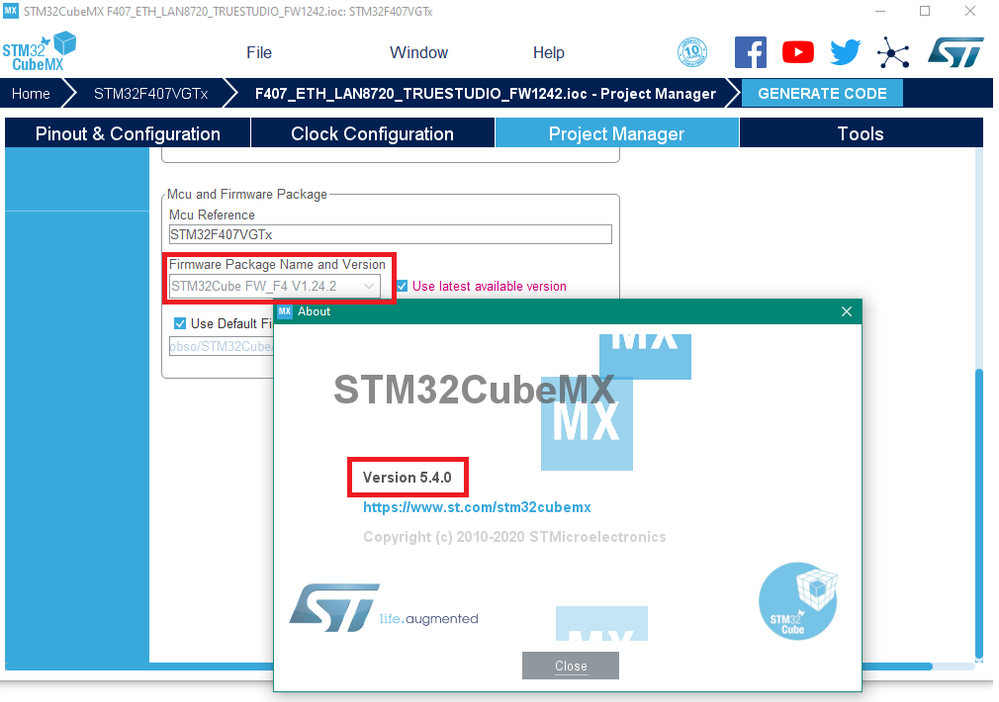

If anyone has any problems with this, try version FW_F4 V1.24.2 or earlier (STM32CubeMX 5.4.0 or earlier).
(More details were added in the first post)
Setup:
2020-03-04 9:04 PM
Correction - Package: FW_F4 V1.24.2 worked.
====== X =======
I was unable to get STM32CubeIDE V 1.3.0 to work with FW_F4 V1.24.1, so I uninstalled the IDE.
I installed version 1.1.0, and for some reason, there was some confusion with the FW_F4 packages, and even after starting the project with FW_F4 V1.24.1, FW_F4 V1.25.0 was appearing when compiling, and it didn't work (ping.exe didn't get a response).
So I opened the package repository folder and removed all packages.
I uninstalled everything again, STM32CubeIDE and STM32CubeMX.
I installed STM32CubeMX V5.4.0 again and the reference for the FW_F4 1.24.2 package appeared (instead of 1.24.1).
I tested with this STM32CubeMX V5.4.0 + FW_F4 V1.24.2 configuration and it worked.

2020-03-09 3:39 PM
Oh Boy! Please confirm what was found.
I created two new projects, one with FW_F4 1.24.1 and the other with FW_F4 1.25.0.
I compiled the project with FW_F4 1.24.1 with Atollic (because there I can configure STlink to just download), the ping (ICMP) worked. The FW_F4 1.25.0 project did not work, as expected.
So I was replacing the project files with FW_F4 1.24.1 until it stopped working. I tapered until I got to the lwip.c.
Then, with the help of the ExamDiff program, it was easy to notice something missing in the file created with FW_F4 1.25.0, as follows:
