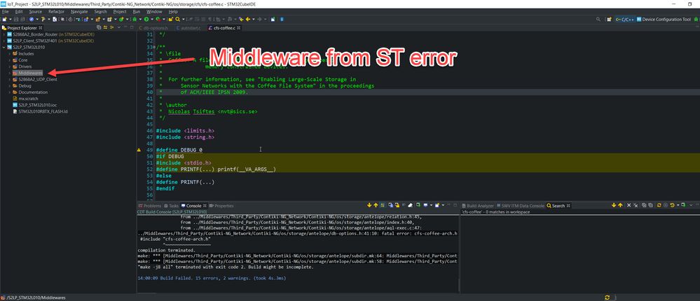

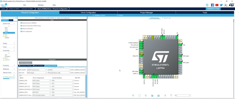

I found bug for generate with SUBG2. I can export file to STM32CubeIDE but it can't be use with other MCU .
This photo. I can generate with STM32L010.
This photo. I compile source code. I found error in middleware from ST.

Actually the issue is the usage of "Generate Under Root" option. If you deselect it, the project compiles.
Well' investigate this problem and solve in future releases of STM32CubeMX and/or X-CUBE-SUBG2 pack.

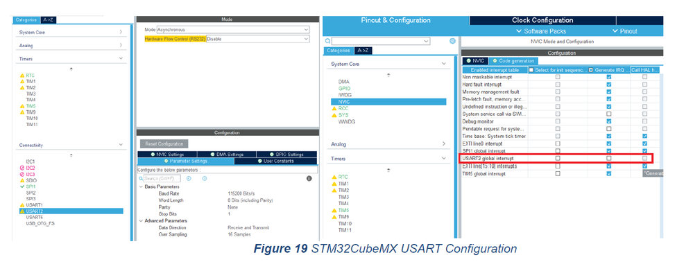

With regards to the IRQ Handler, please check the Getting Started guide, at pag. 21 is documented that you must not generate USART IRQ Handler since this pack needs to generate it on his own.
The ioc has been modified accordingly.

actually it is not a problem of SUBG2 pack. There are 3 things to fix in the orginal ioc file:
1) Please do not use "Advanced application" structure coupled with "Generate under Root". I know they are the default if you generate a new project but I see this combination generates a wrong project (all files of the MW in the project). We'll solve this in STM32CubeMX.
2) Once you solve this, you'll probably get another error: as reported in the Getting Started guide of SUBG2 pack (you can open it in STM32CubeMX in the component view) for this pack you have do deselect the generation of USART IRQ Handler, since it is taken care by the pack itself
3) For this specific platform with very little FLASH, the "Debug" configuration generated by STM32CubeIDE will not fit: try the "Release" one, it should be ok.
