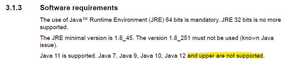

Hi @taraben ,
We are aware of such issue with Java 14 and we mention it in STM32CubeMX User Manuel UM1718.pdf, see below:
But we are working harder to fix the issue in the coming MX version.
I suggest you to go back to another JRE version (e.g Java 11 or Java 8).
Thanks for your comprehension.
