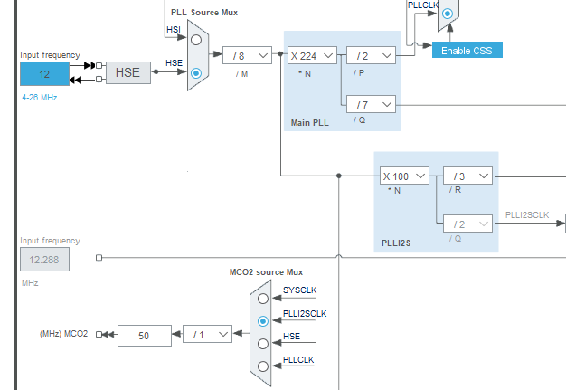

Latest CubeMXIDE, code for F437. IOC to reproduce bugs attached. Here's the clock configuration:
MCO2 required is 50MHz (for LAN8742A).
Clock diagram shows PLLI2S is used to generate 50MHz from external 12MHz crystal /8,
using *100 / 3, then PLLI2SCLK is fed to MCO.
Bug #1
The generated SystemClock_Config routine contains the following:
PeriphClkInitStruct.PeriphClockSelection = RCC_PERIPHCLK_PLLI2S;
PeriphClkInitStruct.PLLI2S.PLLI2SN = 100;
PeriphClkInitStruct.PLLI2S.PLLI2SR = 3;
if (HAL_RCCEx_PeriphCLKConfig(&PeriphClkInitStruct) != HAL_OK)Unfortunately, with these inputs,
the HAL_RCCEx_PeriphCLKConfig routine does absolutely nothing!
PLLI2S is neither set up nor enabled.
The idiotic function just happily returns HAL_OK after doing nothing.
Bug #2:
The CubeMX graphic does not show the output frequency of PLLI2S or PLLCLK
Bug #3:
Updating the PLL2IS x value to 200 fails to update the derived values.
@Markus GIRDLAND - Can you please confirm you can reproduce all 3 bugs and corresponding tickets are opened?
Is there a HAL or LL call that will actually set up PLL2IS properly ???
Or should I just give up on HAL/LL stuff???
For now I've just patched up the STM code to get things working (patched file attached).
Thanks!
Best Regards, Dave

@Amel NASRI Further info:
Bug #2: The CubeMX graphic does not show the output frequency of PLLI2S or PLLCLK.
For all PLL, the graphic display should show the internal PLL frequency and the output frequency,
even if those frequencies are not currently selected.
Otherwise, for example, it is not possible to see if a PLL is in the allowed range, or if one s getting the desired output.
Bug #3: Load the example IOC, and try to change the *N value of the PLLI2S, for example to 150.
You will see the GUI screw up and not take the intended selection, pause a while and change the selection, and otherwise behave badly.
Hope that is clear!
