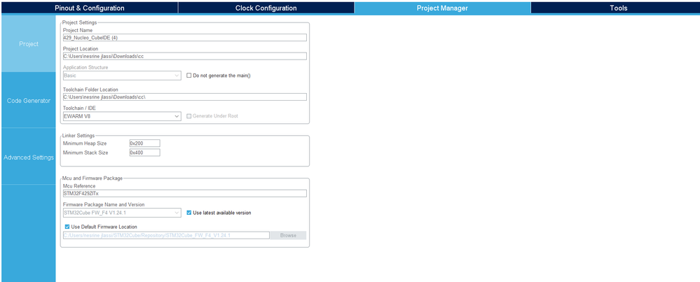

Now, to solve the problem, you can use EWARM as Toolchain/IDE

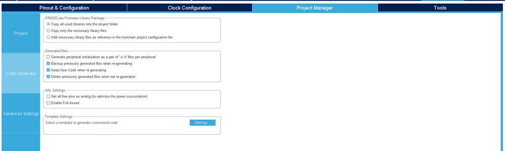

Next, select please "Copy all used library into the project folder".
Then, generate the code.
==> No issue
