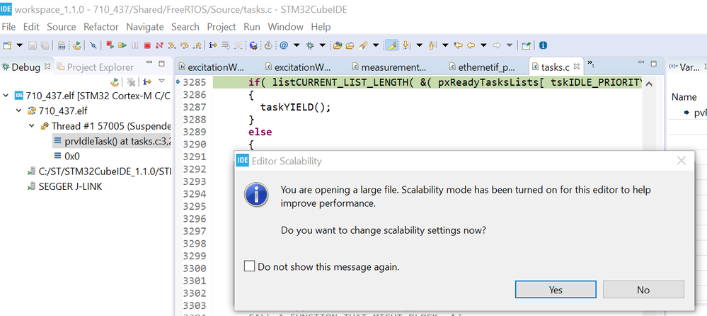

Using Segger j-link on F437.
STM32CubeIDE Version: 1.1.0
Build: 4551_20191014-1140 (UTC)
OS: Windows 10, v.10.0, x86_64 / win32
Java version: 1.8.0_202
When debugging, clicking on the "Detach" icon hangs the IDE, and I have to then kill it with Task Manager. It does this typically after asking about scalability or similar as below (image captured prior killing IDE with task manager).

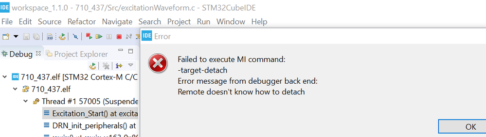

The previous version had a different slightly less annoying bug:

PS: If the first dialog is disabled in a different context with the "do not bother me again" checkbox, the 2nd problem occurs but at least the GUI doesn't hang.

Now I'm using a different MCU on a prototype board and using Segger J-link and (not Segger software loaded into a Nucleo eval board). It looks like there are two separate bugs:
1) If the module interrupted happens to be a huge source file and the scalability warning/settings haven't been set, the scalability dialog pops up and the GUI is completely hung.
2) Otherwise, the disconnect is not processed properly and the Failed to execute MI command pops up.
