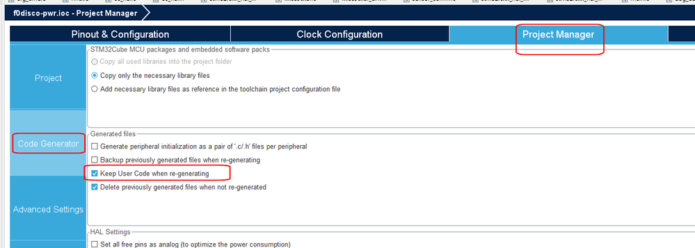

@pass3master wrote:When we change the ioc file in STM32CubeIDE, there is some code that We don't want to be overwritten by the automatic generation. How can we avoid this?
That's what the USER CODE sections are for - see this thread, for example:
See also:
and make sure that you have 'Keep user code when re-generating' selected:
