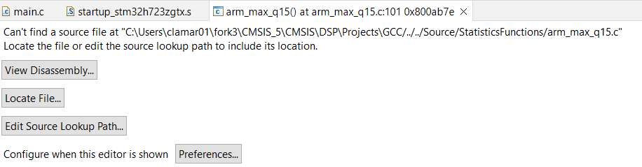

The absolute path ("...\Users\clamar01\...") seems to be a leftover from signal processing engineer "Claudio Martino" at ARM in their CMSIS library files. We get the same message when debugging, but in conjunction with a different function call ("arm_max_q15()").
Screen shot:

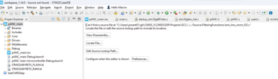

Hey,
did You manage to solve issue with this absolute path? We are facing the same problem with LMS function call (with cmsis downloaded from G4 Cube repository). When we integrated project with CMSIS 5 through software pack in CubeMX there is exactly the same problem but with another username...
2023-12-15 1:44 AM
The easy way is not to debug CMSIS functions. Simply skip the functions when debugging. The orderly way would be to report this problem to ARM. However, I suspect this way is unsuccessful as the code parts were probably intentionally hidden in a library. The harder solution would be to use the free Open CMSIS package instead of the original ARM CMSIS library. In case of doubt, however, this may lead to new problems.
