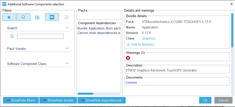

When creating project for STM32H7 board. In Additional Software none of installed packages can be seen. For STM32F7 it works correctly. Is it a known issue?
(CubeIDE 1.2.1)
2020-02-21 4:58 AM
Okey Thanks @slawek
Well , it's not an issue but for the Dual core, it still not supported, it will be in a next release.
Thanks For your feedback,
Best Regards,
Khouloud
2020-02-21 2:10 AM
Hello @slawek
Could you please explain more your case , share your project / screenshots ?

2020-02-21 3:33 AM

2020-02-21 5:17 AM
Thank you for information.
