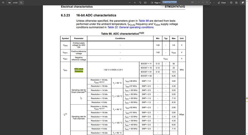

STM32CubeIDE 1.5.1, latest H7 package for STM32Cube.
I have STM32H747-DISC1 board, and STM32CubeMX (in IDE) let me pick max. 36 MHz clock.
According to the datasheet STM32H747xI/G datasheet, ADC clock frequency get up to 50 MHz. I overriden frequency on ADC, and it works fine, so I guess this is a bug.

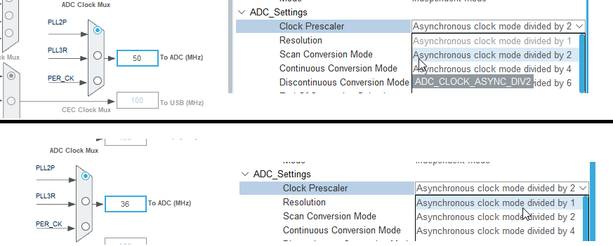

2021-01-27 11:30 AM
Dear Kholoud.
Exactly. When I set 50 MHz to ADC peripheral, in ADC configuration tab, I can pick clock prescaler only 2 and more.
When I set 36 MHz to ADC peripheral, I can set prescaler to 1. This means I can't use ADC to maximum frequency.
(Only if I override it).
Thanks.

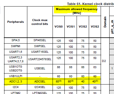

But as far as I can guess , this can be related to RCC Settings in CubeMX. In fact backing to STM32H747 Reference manual and more precisely in 9.5.8 Kernel clock selection section, Table 61 shows the kernel clock that the RCC can deliver to the peripherals:

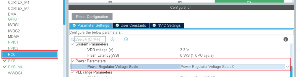

Please check the Power Regulator Voltage Scale in CubeMX:
Feel free to come back to me if your issue isn't resolved.

2021-01-28 6:10 AM
Hi @Despair1337 ,
Let me first inform you that there is known data refresh issue with ADC which is reported internally to be fixed. Sorry for the inconvenience.
Thus, I propose a simple workaround in order to save the modification once you change Power Regulator Voltage Scale :
1- Set the Power Regulator Voltage Scale to VOS0.
2- From the File menu click on Save Project (or use Ctrl-S Keyboard shortcut)
3- From the same File menu re-Load Project (or use Ctrl-L Keyboard shortcut)
I have attached a screen recording to more explain the process.
Khouloud.
