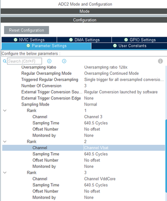

When MX_ADC2_Init() generated by saving IOC file I get the wrong sampling time and rank for Vddcore. The IOC file shows 640.5 cycles and rank 3 but MX_ADC2_Init() shows 2.5 cycles and rank 1:

Compare with IOC view...
Is there something special about Vddcore?

Hello @mccabehm
Thank you for reporting this issue. I've been able to confirm it and I've reported to the concerned team for correction (under internal ticket number 184962).

Hello @mccabehm
This behavior has been solved on the last version of the STM32CubeMX V6.13.0.
