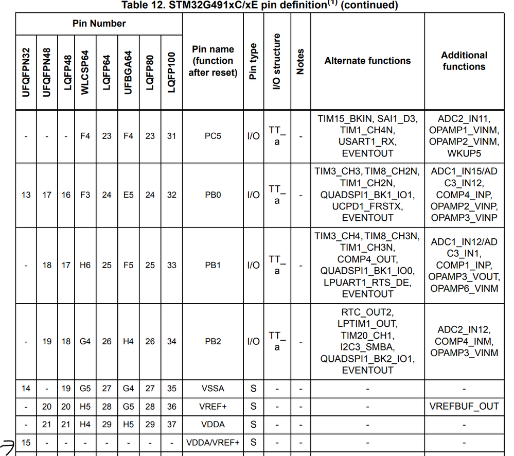

Hello @Osto​,
  1. Could you please precise full product package? Is it STM32G491 UK ? Because I can see for example in UFQFPN32 package, the voltage reference buffer is not available and must be kept disabled. As referenced in RM0440 section 23.1 Introduction : When the VREF+ pin is double-bonded with VDDA pin in a package, the voltage reference buffer is not available and must be kept disabled (refer to datasheet for packages pinout description).0693W00000Y7PfsQAF.png
  2. If not this package, could you precise how do you implement the VREFBUF in the application where do you call the HAL_SYSCFG_EnableVREFBUF(); ? a screenshot of VRR enabled? Tick count is not incrementing?
