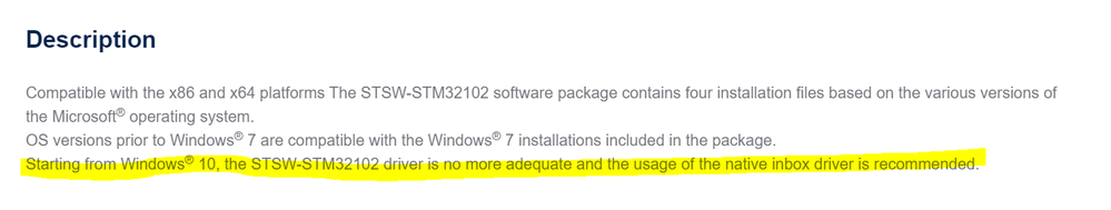

I bought an X-NUCLEO-LPM01A that works very well on windows 8 with the STM32 Cube Monitor-Power software. I had to put the driver STSW-STM32102.
Then, I tried on Windows 10. However, with Windows 10, it is written that this driver (STSW-STM32102) should not be installed because it is natively included in windows 10. But, the STM32 Cube Monitor-Power software cannot communicate with the board... I had to download the driver STSW-STM32102 made for win8 despite it being discouraged.
It works on win10 only with the Win8 driver (for me at least).
