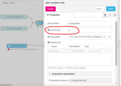

I am using STM32CubeMonitor with the STM32H503CBT6, but I can't observe my variables. Previously, I used the STM32F1, and it still worked.
giangpa_0-1722651032850.pnggiangpa_1-1722651060148.pnggiangpa_2-1722651088289.pnggiangpa_3-1722651122853.png

Hello @giangpa
Can you try on another access port (config to be changed in variable node )

Hello @giangpa
