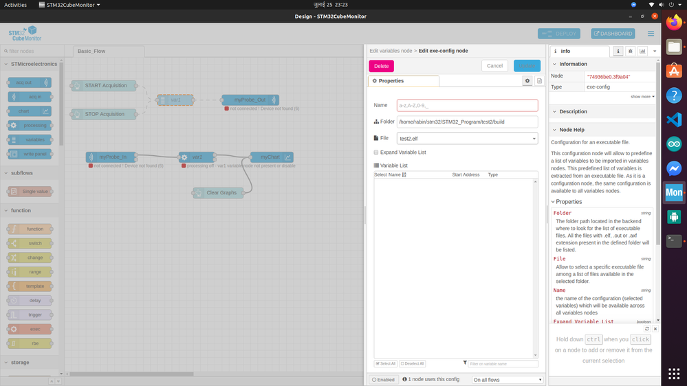

Hello RG,
We have answered a similar issue on following link:
Can you check if libncurses5 is installed on your ubuntu version.

2020-08-29 5:33 AM
Same problem. Fixed with
sudo apt install libncurses5thanks (:
