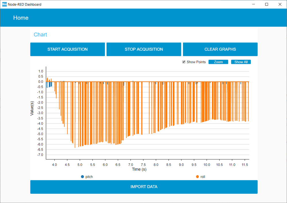

Hi! I have a problem with a chart. It plots the variables but most of the time their values seem to be 0 (what is not correct). I'm using stm32f103re with st-link/v2

Guys, I found what caused this strange behavior, it was
__WFI();

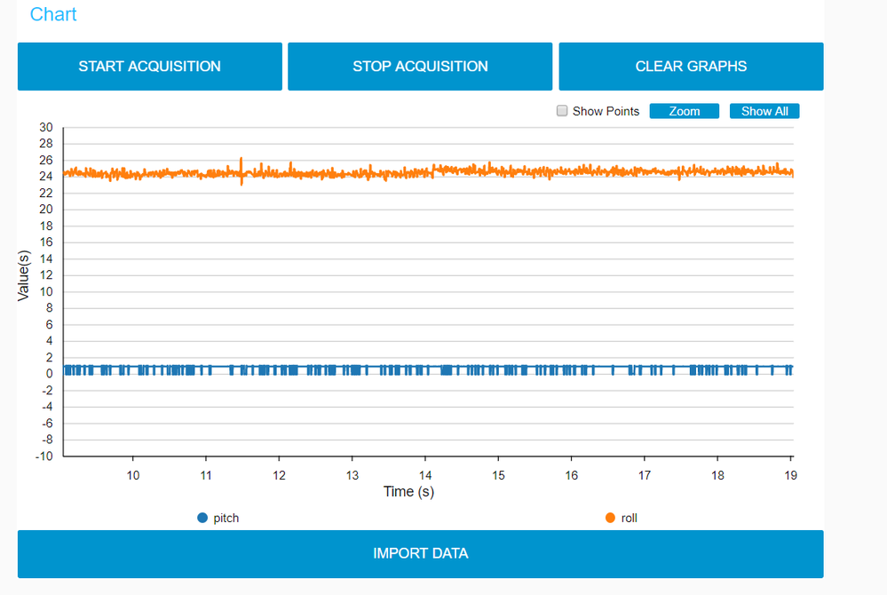

I've tried dicovery board, and it plots just what i expect.0693W000000UB0MQAW.png
__WFI();

stephane.legargeant
When the processor is in WFI, the tool is not able anymore to access the memory : when the tool reads data, the probe returns 0 and not the real value.
So it is not possible to get the data when MCU uses WFI instruction.
