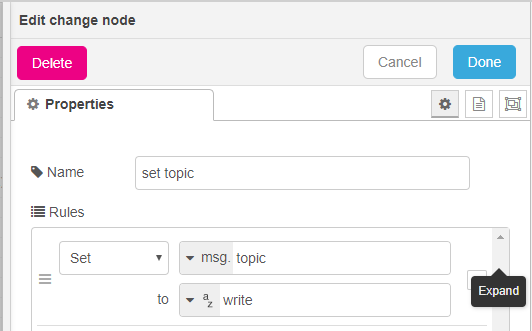

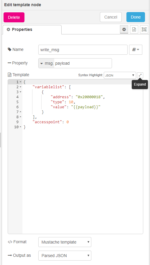

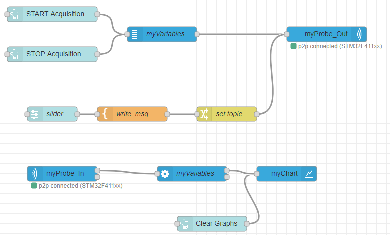

My proposed solution with standard nodes is :
I have added a slider to generate the value (but can be done by any node) then the “template�? node formats the payload, and the change node set the topic.
the template node content :
The variable address and variable type must be filled here. For the type and address, the easiest way it to try first with a write panel and a debug node, and see the values. The payload value from input will be inserted in the template. (the value to write).
The next node is a “change�? to set the topic to write

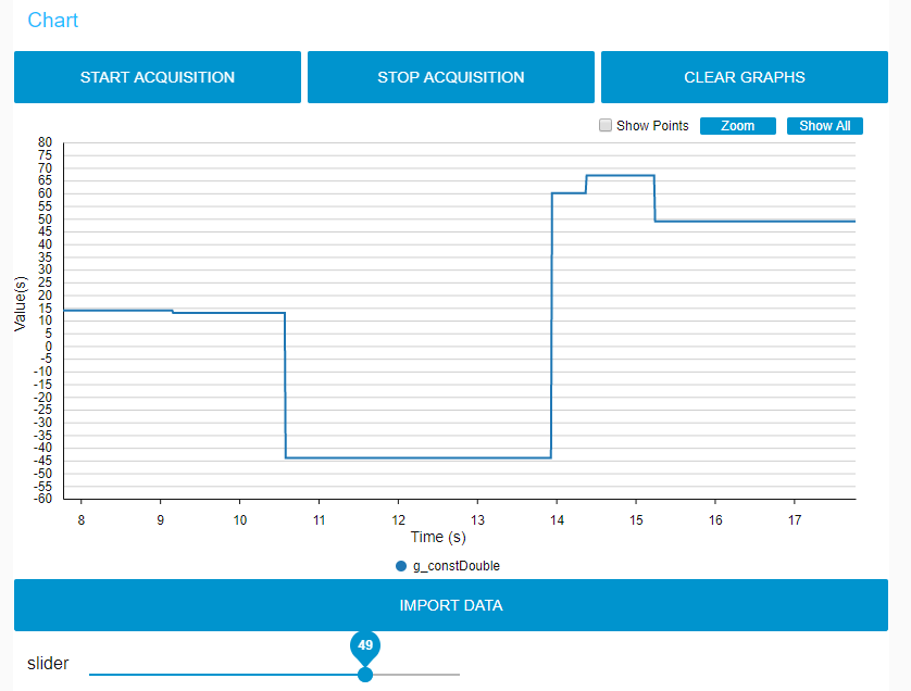

the result :
When the slider is moved, the new value is written to g_constDouble
I attach the 3 nodes flow to the message.
