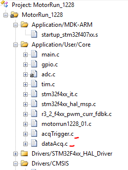

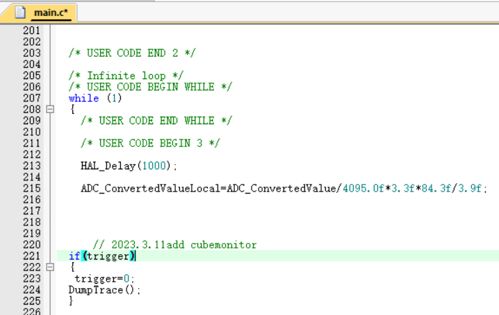

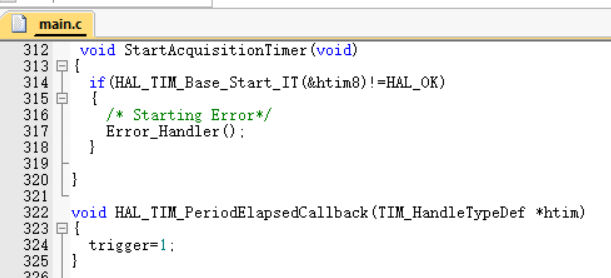

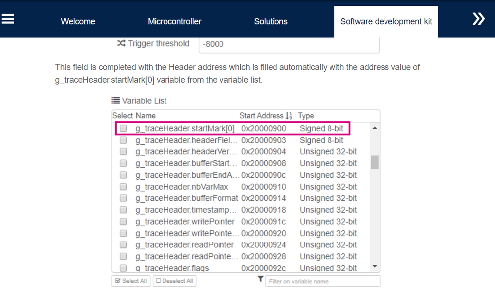

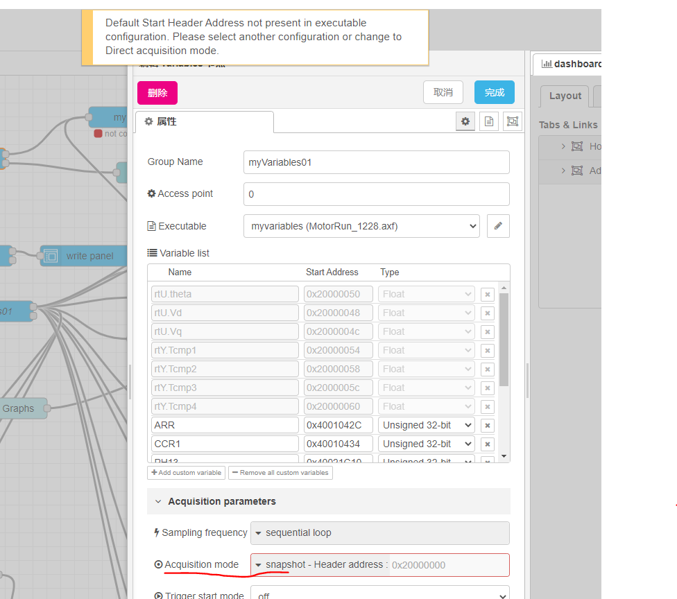

I switch direct mode to snap mode,and add relevant C and H files.But Acquisition mode can't change snap mode. Variable list can't find "g_traceHeader"
which may be my operation error ?

I've seen you've disabled dataAcq.h file, this file is required for snapshot.
Can you please try to include this file and activate USER_TRIGGER option and let us know the status.

However, can you check USER_TRIGGER option status is activated.
