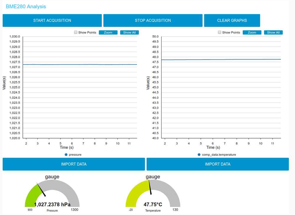

Automatic Y axis range is a good feature, but ymin and ymax are too high to appreciate variable changes when the mean value is high.
In my case I plot an atmospheric pressure that has a mean of about 1025 hPa and a variance around 0.02 hPa, you can understand that the current automatic range setting are not well suited in my case.
To really appreciate the dynamic of my variables, in the case of the attached picture, I'd need for example ymin = 1027 and ymax=1027.5:

Yes I understand but as we speak about atmospheric pressure & temperature, the variation should be relatively slow, and I guess it is not needed to perform value acquisition at high frequency (maybe once every second should be enough by far). If I'm right, the chart from dashboard category might be a good solution to look at. This chart is not provided by ST (then you need to adapt data structure by using split & change nodes), but it supports the range change by msg.
Nevertheless generally speaking I do not recommend using non "ST chart" as with other charts:
1- you will quickly face performance issues because other charts are not designed to get thousands of points per seconds. The performance limitation can be acceptable if the acquisition frequency is limited to max few points per seconds.
2- you will loose out of the box functionalities like zoom, brush, import
