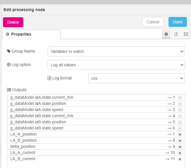

I'm trying to log my data in a .csv file, using the STM32CubeMonitor v1.4.0.
I'm configuring my ST processing node as follows:

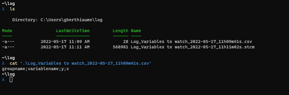

Sadly, it produces .csv with no data in them (see next screenshot).
I also tested the same setup with the .stcm, and it worked.

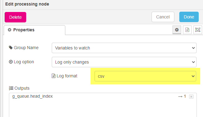

Hello @GBert.2 ,
The problem comes from the '.' character in the variable name, will be solved in the next release.
Regards

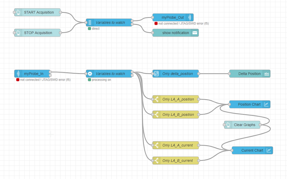

2022-06-23 4:02 AM
Hello
You're flow and configuration looks OK to me, quite strange behavior...
You can duplicate your processing node, one using stm output , other csv and check. If stm file is not empty and csv is, there's an issue on ST side to be investigated.
