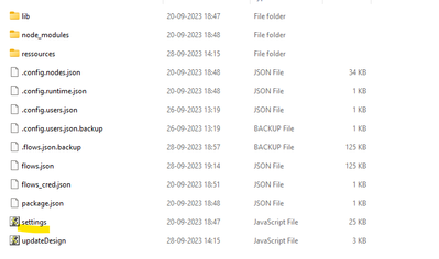

The directory path where you can find the log files could be configured in settings.js file ( default path is home directory / log ).
When you say settings.js is the below file
what changes i need to do to change the log path.

Please have a look to stm32cubeMonitor wikis:
https://wiki.st.com/stm32mcu/wiki/STM32CubeMonitor:How_to_change_general_settings
https://wiki.st.com/stm32mcu/wiki/STM32CubeMonitor:How_to_log_data_in_a_.csv_file

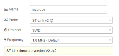

I can see you've attached a STLinkV2 but what is the device probe connected to the STLINK?

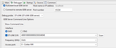

I really don't understand the device probe mean, but the below is the configuration i use when connecting the ST link debugger when running Cube Ide. Is this what you are asking?

Just wanted to know which MCU you're using,  STM32xxxxx? Because some devices like STM32WB55xx goes to sleep mode to optimize power consumption and therefore disconnects.

STM32G431RBTX is the micro and it is motor control application, when i give command to start the motor then it gets disconnected it is just one observation not every time.
