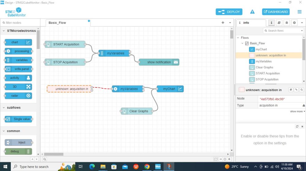

In the cube monitor I didn't have acquition in and acquition out nodes , how can I add these nodes to my pallette and send me the links to install these nodes to my palletteWhatsApp Image 2024-04-10 at 11.32.04 AM.jpeg

in my windows 10 i installed latest cubemonitor windows 18.1.0 version
I am having the same issue. Freshly installed CubeMonitor (v1.8.0).Looking within the "Manage palette" tab the acquistion and probe modules are not ticked and cannot be ticked. Uploading and debugging using stm32 cube IDE (also freshly installed with most recent version) works fine

Hello, I alsow have same problem. I just installed CubeMonitor v.1.8.0 onto my PC with clear OS Windows 10 x64. But I have missing nodes "acquisition in" and "acquisition out". Any help, please?
Heya!
I managed to solve this issue!
Assuming you have installed the drivers and server correctly what I had to do was go into where the server you installed is located and run the .exe for the first time
Go into where the installation happens. For me it was:
C:\ProgramFiles(x86)\STMicroElectronics\stlink_server
and then run the stlinkserver.exe file
After this the acquisition nodes appeared!
