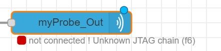

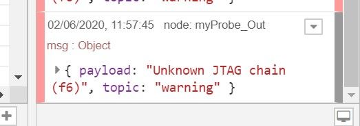

I have successfully built and downloaded the motor control application using ST motor control workbench and the CubeIDE etc and can connect to flash and step through my program. However when it comes to using CubeMonitor i get an error giving "not connected ! Unknown JTAG chain (16)"
In the config screen i can flash the LED on the board ...
I have tried both protocols SWD and and JTAG .. Can i use monitor with the BG431B-ESC1 board ?

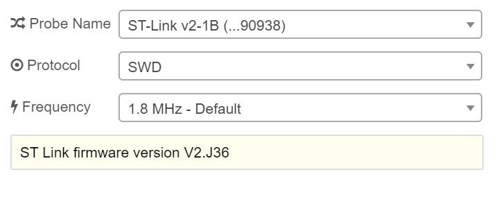

Ha actually I fixed this by deleting and re-adding the the send and receive nodes and configuring as SWD protocol...!!

This error should only happen when the board is not supporting JTAG.
Can you tell me if the error is the same when testing in SWD and JTAG modes, i.e. 0xF6 ( Unknown JTAG chain) in both cases.

Yes i get (F6) irrespective of the selected protocol...

In order to double check, can you please, with your configuration, move back to JTAG protocol , check the error is still there and then move back to SWD and check it's OK (don't forget to press DEPLOY button in between).
I just want to be sure you're not in a config where CubeMonitor does take protocol change into account by mistake.
