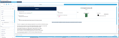

Further to your comment, I suggest that you take a look at this example "ADC_RegularConversion_DMA" provided on STM32CubeMX. It explains how to use the ADC1 and DMA to transfer continuously data from ADC1 to memory.
