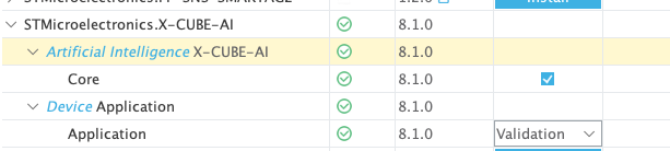

Initially I was developing with a NUCLEO-G070RB board. With that board I can open up the .ioc file, select X-CUBE-AI Core as well as the application for validation. 

  9. Click X-CUBE-AI and click core and in the application dropdown select validation. Like the image in my earlier post. Then select OK to close that view.
